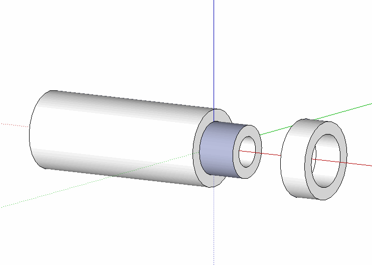

Re: bamboo - general questions
Hi Daniel,
I got your PM, but figured I would post here for the benefit of anyone else wondering the same thing.
Bamboo, when used on a pipe, is best viewed as a "shank extension" instead of being part of the stem. To that end, most pipe makers adhere the metal tube to the stem, and the mortis resides in the bamboo. That way you know you've got a tight fit that won't tend to loosen over time. A ring of acrylic or ebonite is also used to strengthen the bamboo, and help prevent splitting by a careless smoker.
What you want is something like this:
The piece on the left is the bamboo, the ring on the right. You can turn the little spigot (the short tenon on the end of the bamboo) on a metal lathe, but it's just as easy to do on a wood lathe.
My process goes like this:
- Drill mortis in stem end of bamboo
- drill mortis in bowl end of bamboo
- Drill airway in bamboo
- chuck the drill bit I used for the mortis in the headstock of my lathe, and use a cutoff tool to cut the spigot in the stem end, checking with a straight edge for squareness and calipers for correct diameter
- flip the bamboo around and face the bowl end square to the mortis
- Epoxy the oversized ring onto the spigot on the stem end
- countersink the bamboo flush with the ring once the bamboo is cured
It might sound complex, but it's really not. The size of tube I use is usually .18" OD, with a .16" ID. For really tiny bamboo I have smaller tubing, but I rarely use it. This OD equates to roughly 4.5mm, which should leave lots of room to work.
