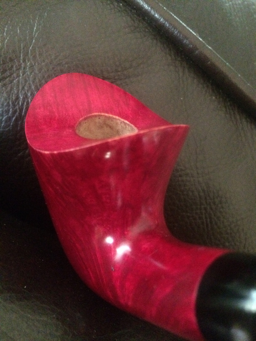

Hello all!
I've just recently finished up this Dublin/Freehand pipe and I ran into a little problem. While I was polishing the pipe with tripoli, some of the stain became removed around the edges of the top of the bowl (sorry I couldn't get a good picture of it!). I used Fiebings Leather Dye, and I let it dry overnight before polishing. Does anyone have any tips on how to avoid removing stain off of the edges like that or is it just a matter of being careful?

Being careful when buffing. Its a tough one and definitely takes some practice.

I stopped using tripoli on the stummel for finishing. I sand to a high grit and go right to white diamond and wax. Tripoli can be used, though, as long as you use light pressure against the wheel. Too much pressure and you'll get light edges like this.

Be careful. If you have removed stain from edges, dip a cotton bud (q-tip as you foreigners call them) into the stain you used originally, wipe off the excess so it is almost dry and then carefully run it over the edges you buffed. Follow this with a soft cloth and then wax as normal. This is normally enough to fix things or at least make it a lot less noticeable.

And for some reason the red colors seem to be the most susceptible to this.

Thanks for the tips! I figured I should probably work on my technique by not using as much pressure and with the way the pipe is angled when polishing. Do you all have any suggestions on the rpms that should be used when polishing with white diamond/carnauba?

Depends on wheel size etc, and the big thing is never presenting the edge to the oncoming face of the wheel - you want that to be the last thing the wheel touches, and gently at that. 750-1000 rpm is probably pretty good with 6 to 8" wheels.
