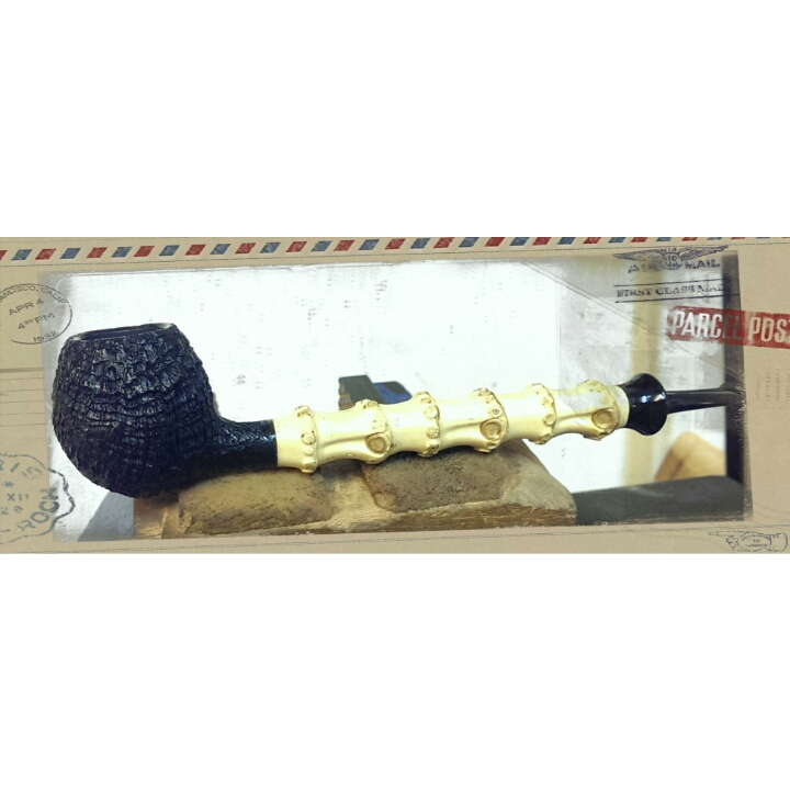

Re: PITH 2015
A little out of proportion in places, but it came out ok. Enjoy!

Re: PITH 2015
I was lucky enough to receive this pipe from Jason, so as per his request here is my 'warts and all' review!
I am being picky, as this is a lovely pipe, and my own skills are limited, but thought it best to spot anything i could as my end of the deal! It's had 3 smokes so far.
Firstly and most importantly it smokes beautifully, and the engineering is spot on. FWIW it passes a cleaner effortlessly.
Nice crisp slot and button, with bang on 4mm behind it. The stem thickens a little quickly from the button for my taste, making it less comfortable to clench than it could be. Only a fraction, but enough to make a difference. I would have liked the 4mm to extend maybe 10mm or so before thickening significantly.
The finish on the stem is great, and i love the offset bead around the stem. There are still some tool marks visible in the indent matching the bamboo on close inspection. The bend is nice (Danish style under-bent which looks pretty), but it still balances well as I smoke.
The band at the top of the shank is well finished and fits perfectly. At the other end of the bamboo the fit is again good, although a bit of stain is on the bamboo there.
On the back of the shank a bead replaces a lost bamboo nodule. There was a bit of glue visible around it, but a few minutes with a soft brush cleared that up.
The line from bamboo to stummel isn't a smooth curve or a ridge echoing the bamboo extension, but a bit in between. I think maybe matching the curve of the bamboo in one line from extension to bowl may have looked a bit smoother. To be fair it is only 1-2mm or so off that though, and the bowl shank join is really nice. Again under the shank i think a slight adjustment to a smooth s curve would have been an improvement.
The stummel shape i love (kind of a dublin/ballerina?!). The lines curve perfectly without bumps, and the lines are sharp. The finish is great, although on a couple of the sharp lines the stain is lighter from buffing the hard edges. (we've all been there!).
The plateau is finished very sharply and is nice and clean. I like the line of stain at the top of the chamber, and the chamber is the smoothest i have tried (what grit is it sanded to?!).
It sits surprisingly well, and i wouldn't worry about resting it on a flat surface mid smoke or for storage.
My thanks to Jason. I may be a noob maker, but have a decent collection myself, and this certainly stands up with some well respected carvers IMHO.

Thanks for the kind words and critique. Most of those I was aware of when I finished but I appreciate your honest opinion. I hope you enjoy the pipe for many years.
