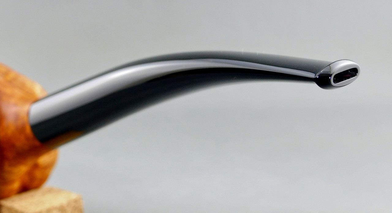

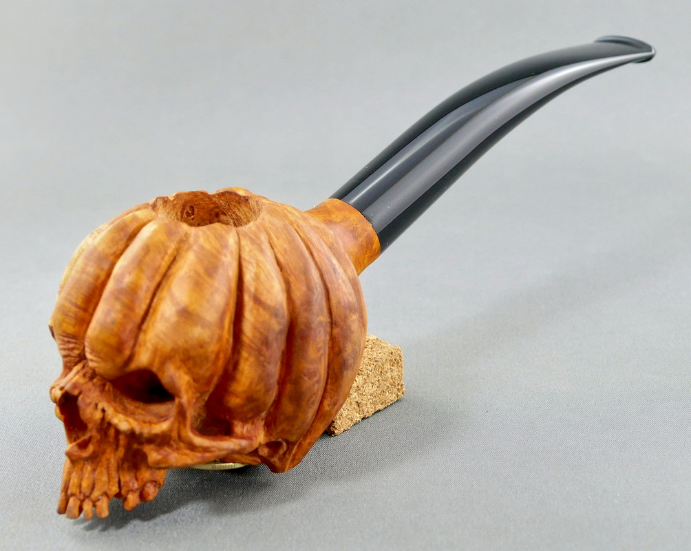

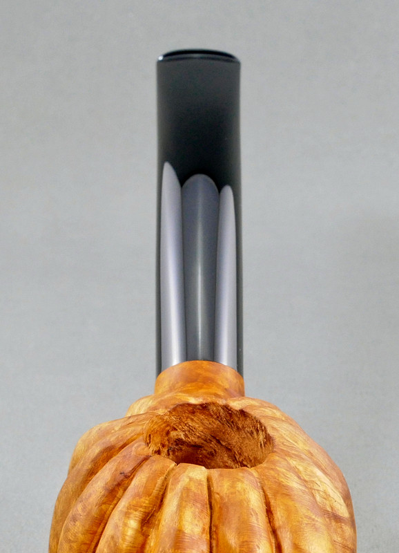

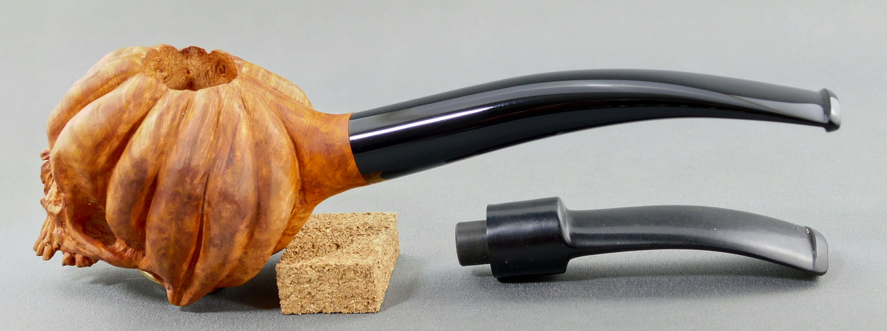

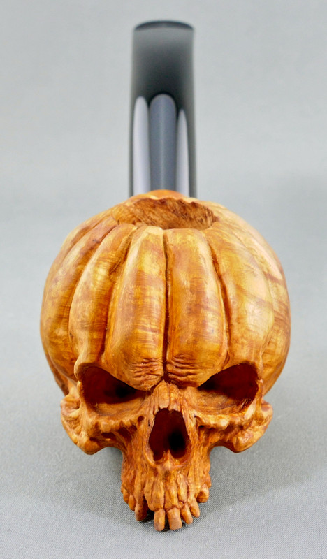

Anyone remember the movie Pumpkinhead?
That was a summoned demon the kids just named Pumpkinhead. This pipe actually IS a Pumpkinhead.
I don't know if the carver was/is a creative guy who makes all kinds of stuff, or a pipe maker who specializes in monsters 'n shit.
In any event the pipe's owner wanted a longer & more elegant stem made for it that matched the quality of the bowl, so here we are.
(For those who are wondering, yes, it did try to bite me while working. Made a creepy-snarly sound, too.)
