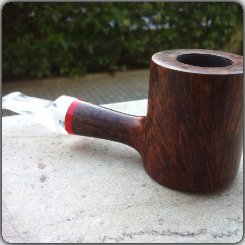

Some of my last work
(223.62 KiB) Downloaded 1290 times
(204.21 KiB) Downloaded 1291 times

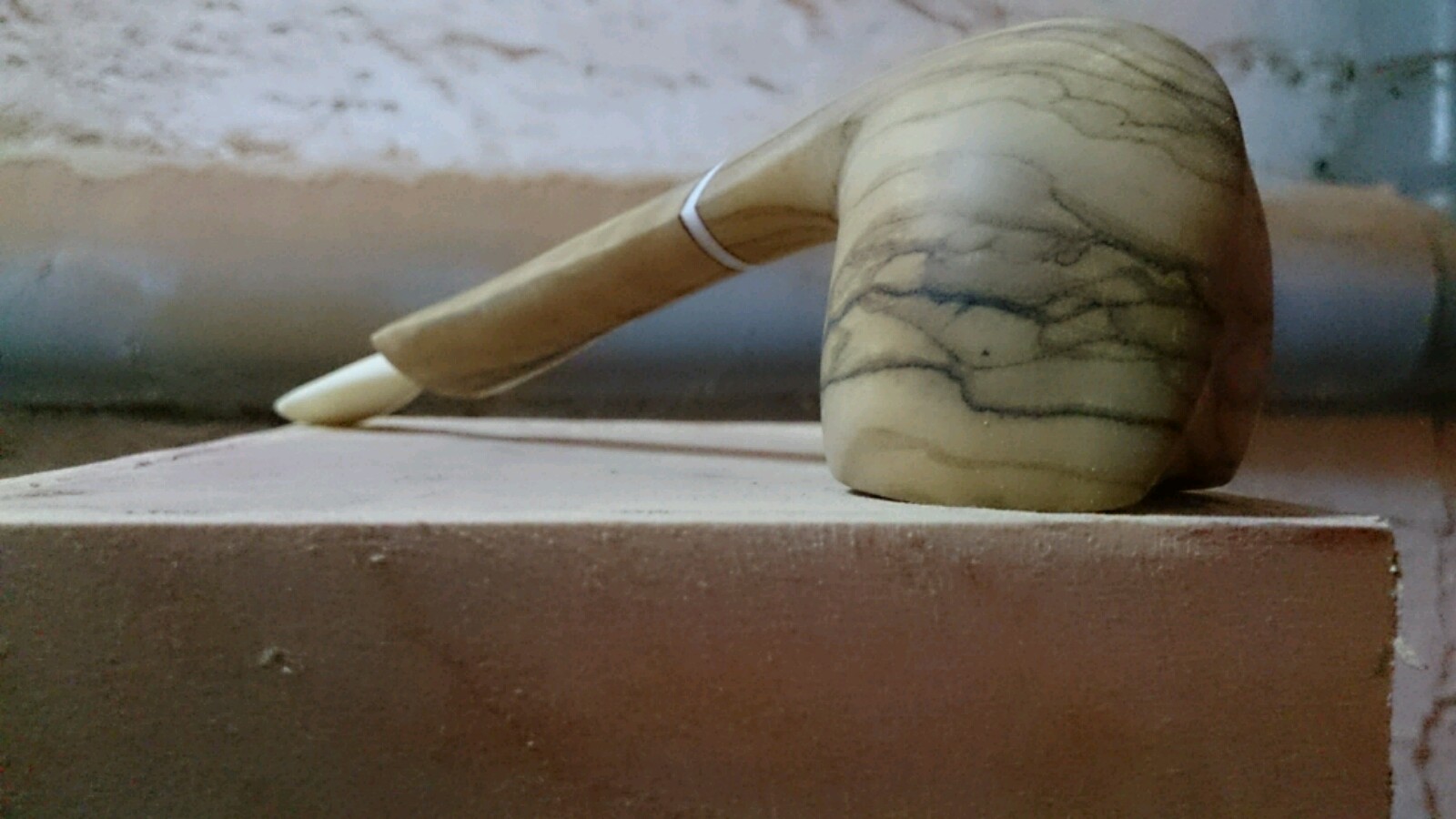

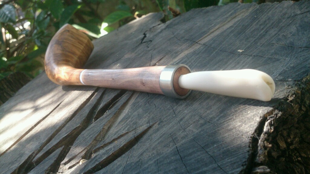

You need to sand your tobacco chambers before applying bowl coating. The oils from your fingers, buffing compounds, and wax can prevent the coating from bonding to the briar especially near the rim where you tend to get the bulk of those things. It's especially true if you're using the waterglass or milk paint recipes.
The reverse taper shank on the first one doesn't really go well with the cylindrical bowl of the poker/cherrywood shape here because it looks too organic for the more geometric shaped bowl.
The second pipe looks pretty good. Just need to dial in your finish.

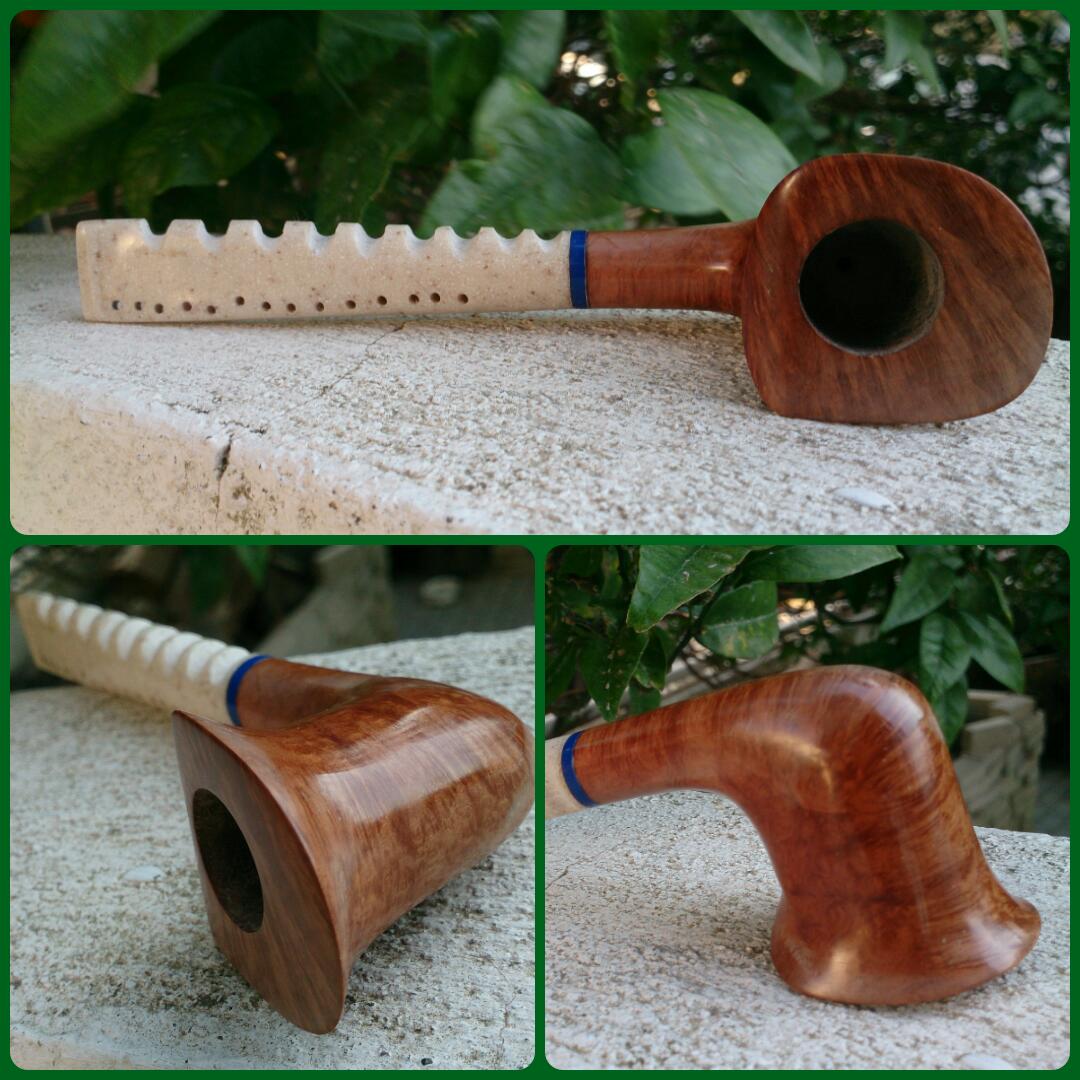

Another Poker,Hollywood and the mouthpiece
Is made with Corian (acrylic stone),
(115.91 KiB) Downloaded 1173 times
(63.42 KiB) Downloaded 1173 times

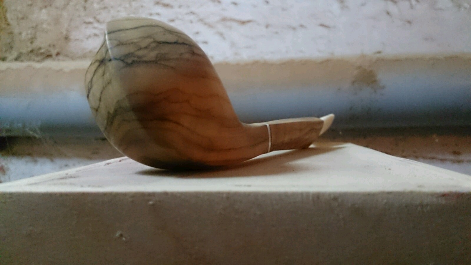

A Lovat from wild cherrywood
(220.75 KiB) Downloaded 1170 times

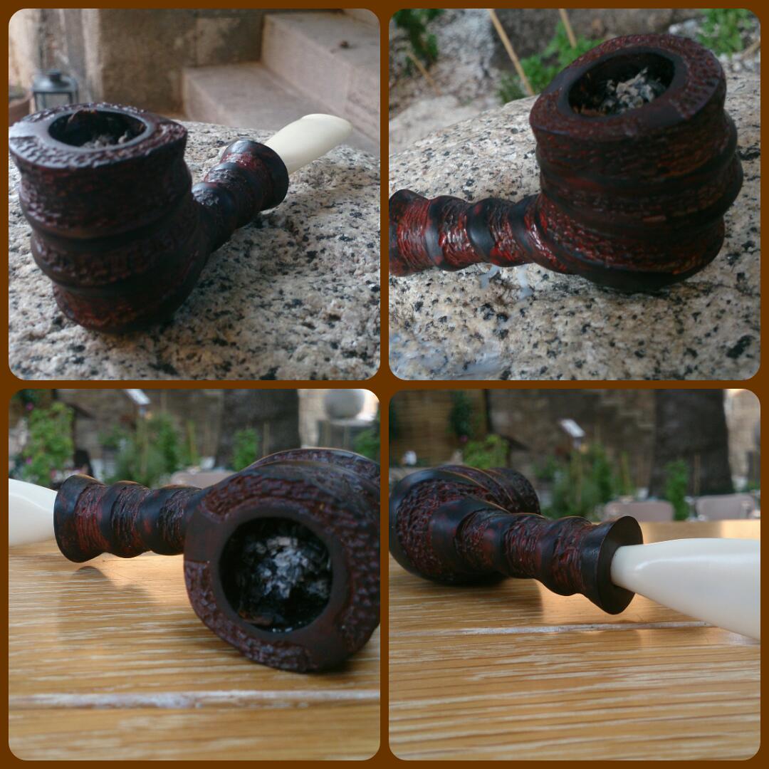

The Armor pipe inspired from the Medieval Town
of Rhodes and the Knights...
(123.1 KiB) Downloaded 1134 times

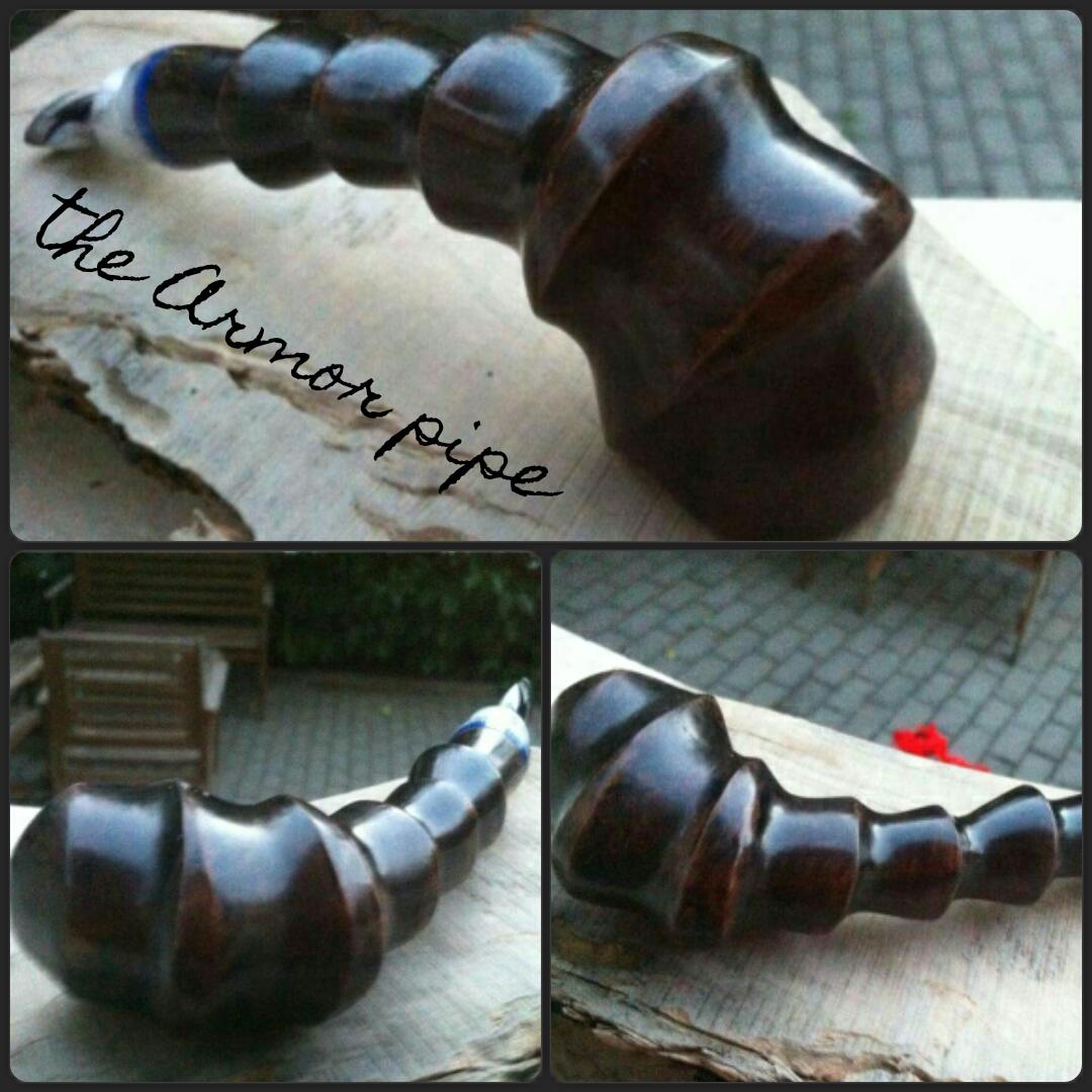

The Armor pipe||....
(145.96 KiB) Downloaded 1009 times

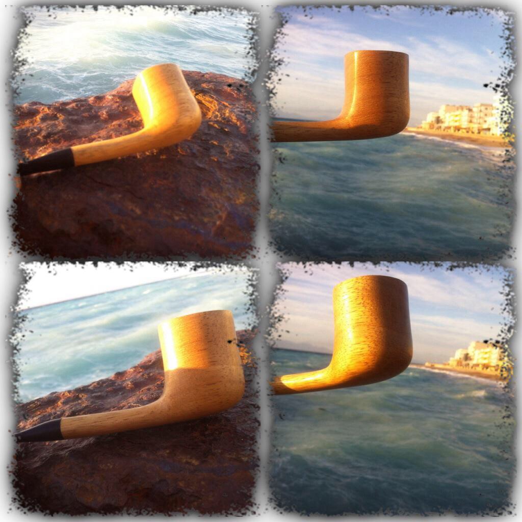

Another olive wood pipe....
(152.37 KiB) Downloaded 956 times

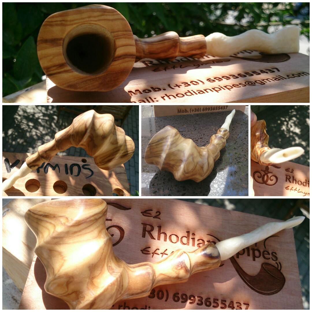

The" Titan pipe"... Almost 30 cm long,Olive and strawberry wood...
