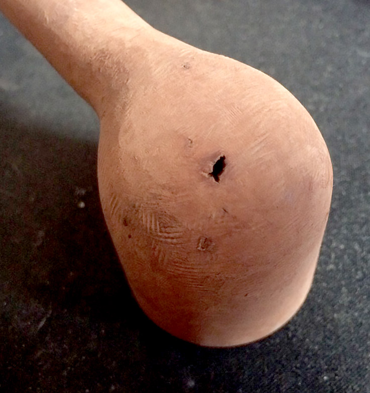

alexsar
Posts: 3
Joined: Wed Apr 27, 2016 6:17 pm
Re: Fixing leakers at shaping
Post by alexsar »
It all sounds pretty easy, but what about the temperature?
At least one of the pits seems to be at the bottom of the chamber where the temperature should be pretty high.
Will it be safe to use epoxy or super-glue there?
Well, I'm asking because after few hours of drilling and shaping of what was supposed to become my new port I just came across this look-through...
Any chances, or just few minutes of fun for my dog?
(138.87 KiB) Downloaded 15 times
sandahlpipe
Posts: 2106
Post by sandahlpipe »
I usually inspect the chamber for flaws as soon as I've drilled the block and before I get too far with shaping. If I spot a flaw in the chamber, I usually just ditch it. Having said that, read the specifications on your epoxy to see how high of heat it will withstand once it cures. Then also coat the chamber with a bowl coating. But don't sell something like that. Or, just set it aside as a dog toy or for practice somewhere along the way.
Posts: 1114
I remember reading years ago that some of the European mass producers used a mix of water glass (sodium silicate ?) and briar dust for their fills. That should be pretty heat resistant.
alexsar
Posts: 3
Post by alexsar »
sandahlpipe and DocAitch,
thanks a lot for your input!
Looks like sodium silicate (liquid glass) + briar dust could be a solution...
Thanks again!
