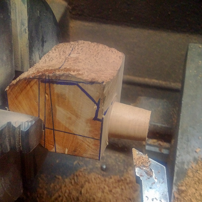

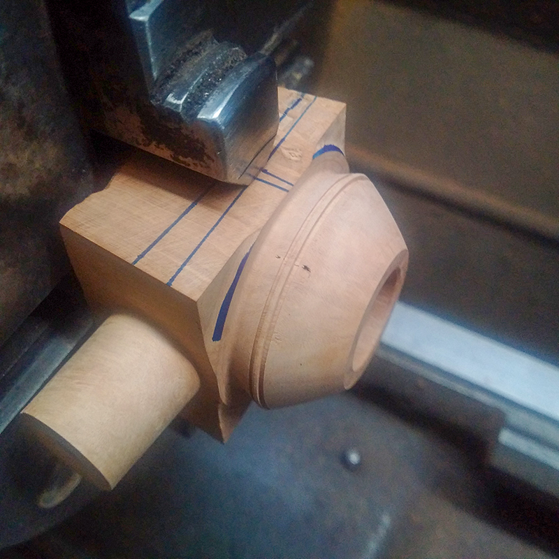

The first Bulldog I've turned showed some sandpits passing through the Rings, So I cut them to make that stummel sandblast/rusticate (I forgot to take a pic after removing the rings!).
(462.1 KiB) Not downloaded yet
