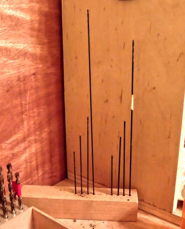

One thing that grabbed my attention. After you had the stem fitted to the shank you said you then cut it to length. I assume you use a tapered bit when drilling then finish it off with 1/16? So I assume you stop drilling with the taper around an 3/4 of an inch then finish with the 1/16 so you can trim down from that side? I always try to have the length guessed out so I don't leave as much room, I probably stop around 1/2 inch. I believe I will start doing it how you did though, leaves a lot more room for error, and I make plenty of those.....

Yes to all that. I drill in with the tapered bit some certain unspecified amount that is less than "Oh shit that's too far" (having some rough idea what I'm making, be it a lovat or whatever). Then I choose the actual stem length visually, with the thing actually sitting stuck in the stummel, masking tape is handy... then I cut it a hair long, face it up on the lathe, drill in with 1/16" to an inch or so, then flip it back around, figure out how far I want the tapered bit to actually go, where it needs to end, and I drill that and hopefully shit connects.
Inside my drilling methodology of both stems and bowls, there is a little repeating, a little "let's finish this later". I cut the chamber some way, cut the pipe bowl, then drill the airway and do whatever work is being done on the shank, and then I'll re-mount the bowl and finish the chamber, cutting down to hit the airway. Why bother? Cuz it lets me work on the bowl, maximize grain etc before I have to choose any details about the shank. (So for example Askwith thinks I'm nuts to do things in this order, preferring to start with shank and airway).

There's a way to work faster and more accurately (guaranteed perfect axial alignment) at the same time with goofy-long drill bits, if that floats your boat.
They're available up to 12":

Awesome, thanks for that. I think I will start doing my stems like that. Makes a lot of sense to me.

I know Tyler uses long 1/16" bits to carry on cutting, rather than flipping anything around.
I like to mount the stem, look at it for length, and decide at the last second just exactly how long I want it, I don't feel like that's a decision I make (unless I'm building from a pattern) ahead of time, so I don't like the risk of going too far with the tapered bit.
And if a guy isn't working on a lathe, yeah, you're probably better by a long shot to keep drilling down the same hole rather than bung something up flipping it end for end.
