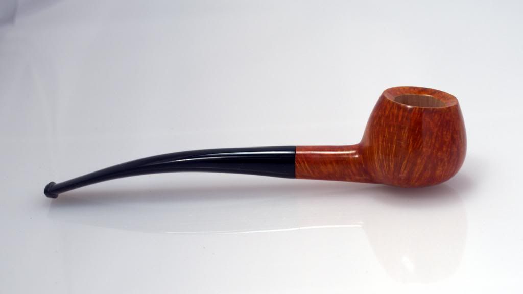

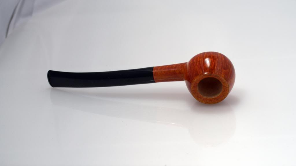

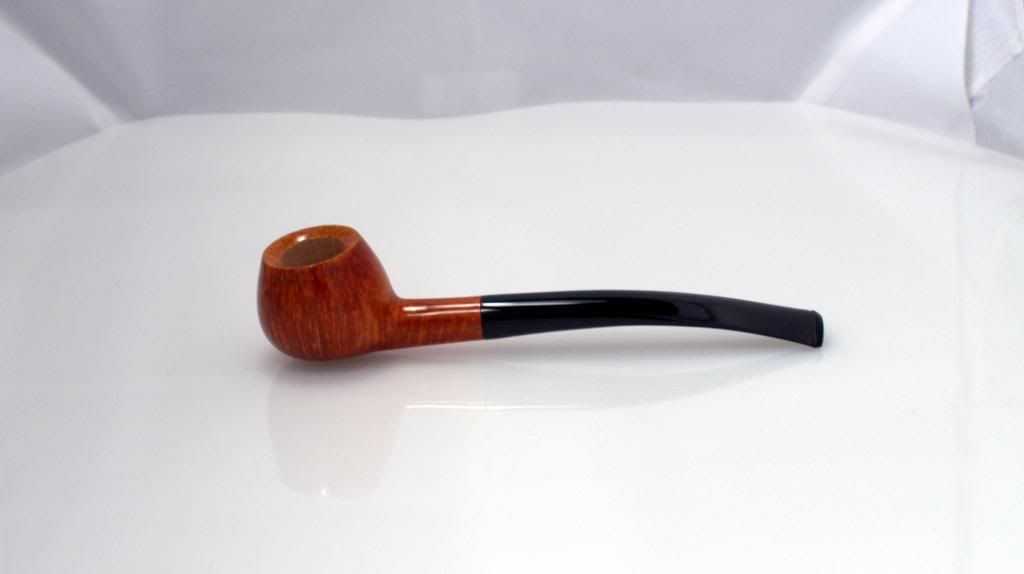

notow1
Posts: 218
Joined: Mon Apr 15, 2013 10:09 pm
Location: Lake Zurich, Illinois
Re: 2014 Pipe In The Hat Trade.
Post by notow1 »
I'm not getting better at photography but was hoping I could get an opinion on whether this is close to being a prince. I think it is squat enough but would like some pipe makers opinions. Thanks for any advice and opinions, Norm.ImageImageImageImageImageImage

notow1 wrote:I'm not getting better at photography but was hoping I could get an opinion on whether this is close to being a prince. I think it is squat enough but would like some pipe makers opinions. Thanks for any advice and opinions, Norm.
Norm,
That is really very close. Nice work!
fuchi_jeg wrote:I finished my prince and shot some photos with my new lighting set up today. Hopefully these pictures are much better than previous attempts. I need some advice from Rad, or Wayne, or anyone who is cutting tenons with a wood lathe. Im not sure if my issue is with cutting the shoulder or polishing the tenon but I sometimes get a small light gap when the pipe is finished. What kind of tool are you guys cutting the shoulder with? I am still dialing in the new DSLR so if anyone has any tips on photography or shaping on this pipe please let me know. Thanks for all the help and advice given over the last few years. I don't think that is ever said enough.
Pics look good and so does your finish. This is more of a brandy to my eye because of the height. It you chop off... mm... 1/8" from the top of the bowl you'd be much closer.
That's about what I was going to say. :lol:
Cut down the top a bit.
I think if you cut the bowl down it would look more "prince like" but I also think that if you asked any pipe guys, who aren't in the throes of trying to make a classic prince, what shape it is they would call it a prince. You've got a nicely finished piece, there. I say leave it and make another if you want to get a little more classic on proportions.
