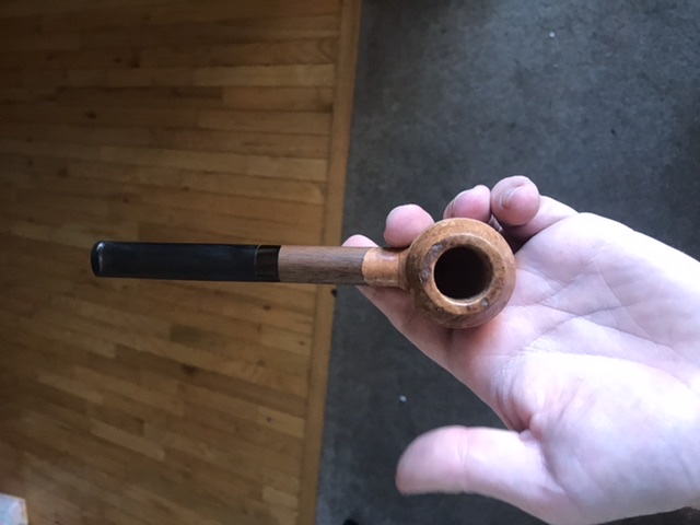

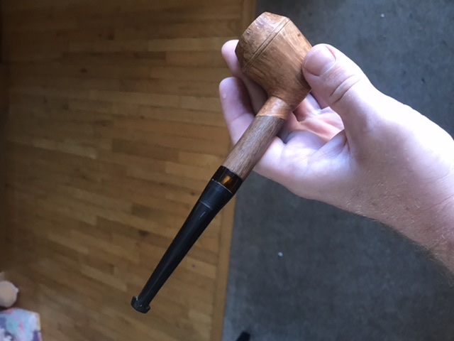

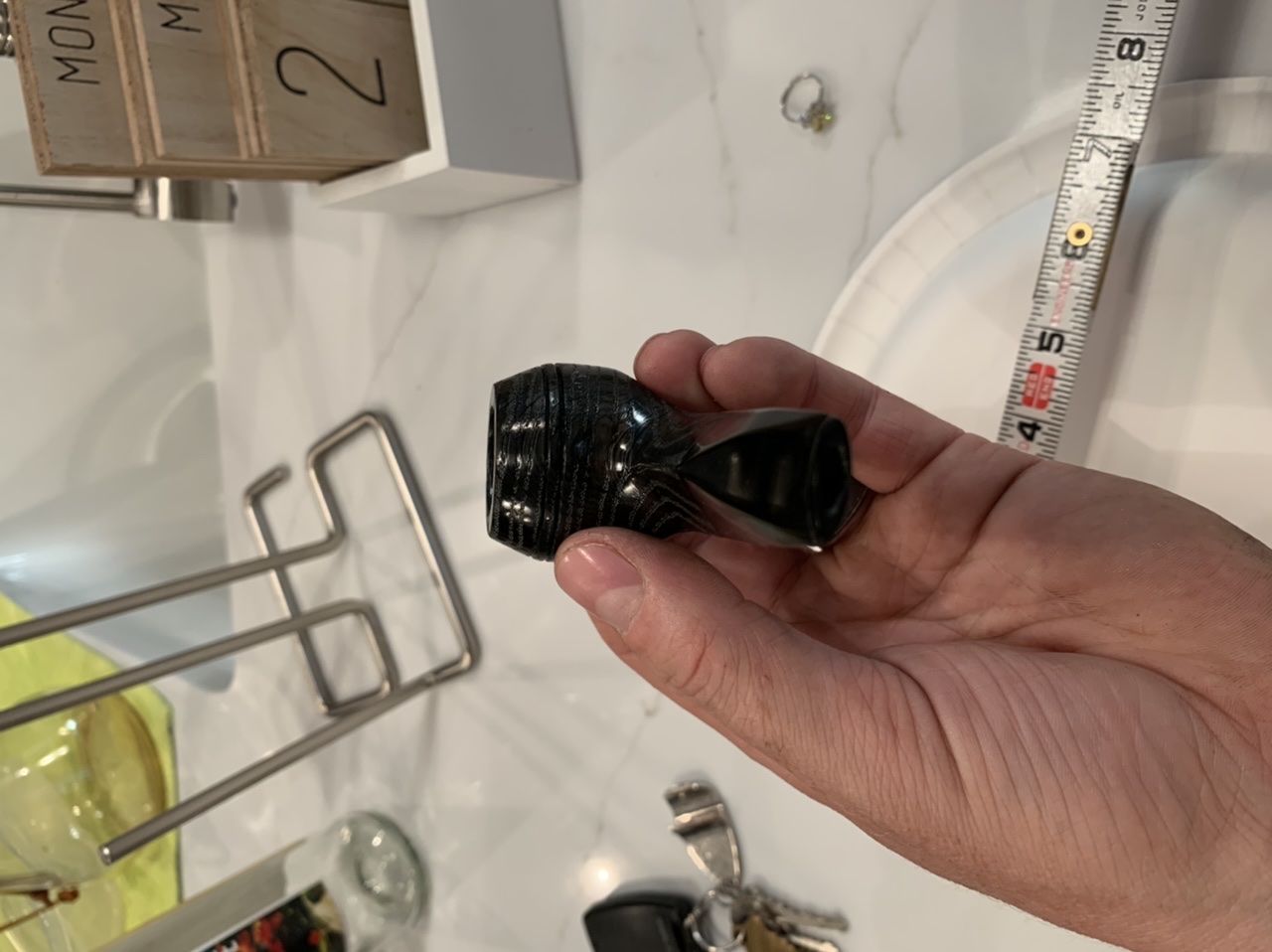

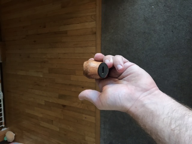

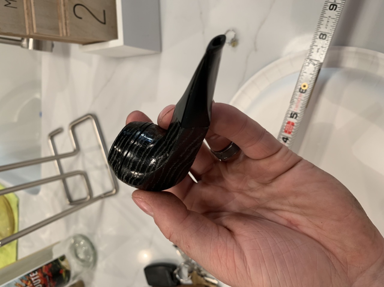

So far this is my best attempt at a bulldog. I’m hoping this is -not- my PITH entry, but if things keep going the way they are now, I won’t have time to complete another. Fingers crossed though. Please any and/or all feedback anyone may have is more than welcome. Thank you all!

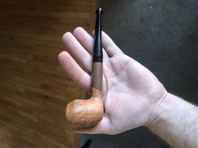

A couple more pics. I’m not good at the photo taking lol

Post by J. Mouton »
Nboothe, just a suggestion but maybe you could try a round shank. Unless you junction is perfectly square to lines on the diamond shank you will have gaps. Also try not to bring your taper on your stem all the way up to the shank. Leaving a small amount of shank profile on the stem will be more appealing to the eye. Short tapered bits like that are harder to get right and tend to be uncomfortable. You could have made a saddle bit to over come the steep angle. Best scenario on that style of bulldog would be making the stem the same length as the entire stumle. Lastly you are working with morta which is also making it harder for you to achieve proper shaping. My suggestion would be to go on smokingpipes.com and pick a nice looking Rhodesian about 4.5 to 5 inches in length. On their website you can scroll down and get every measurement you need to execute the pipe.

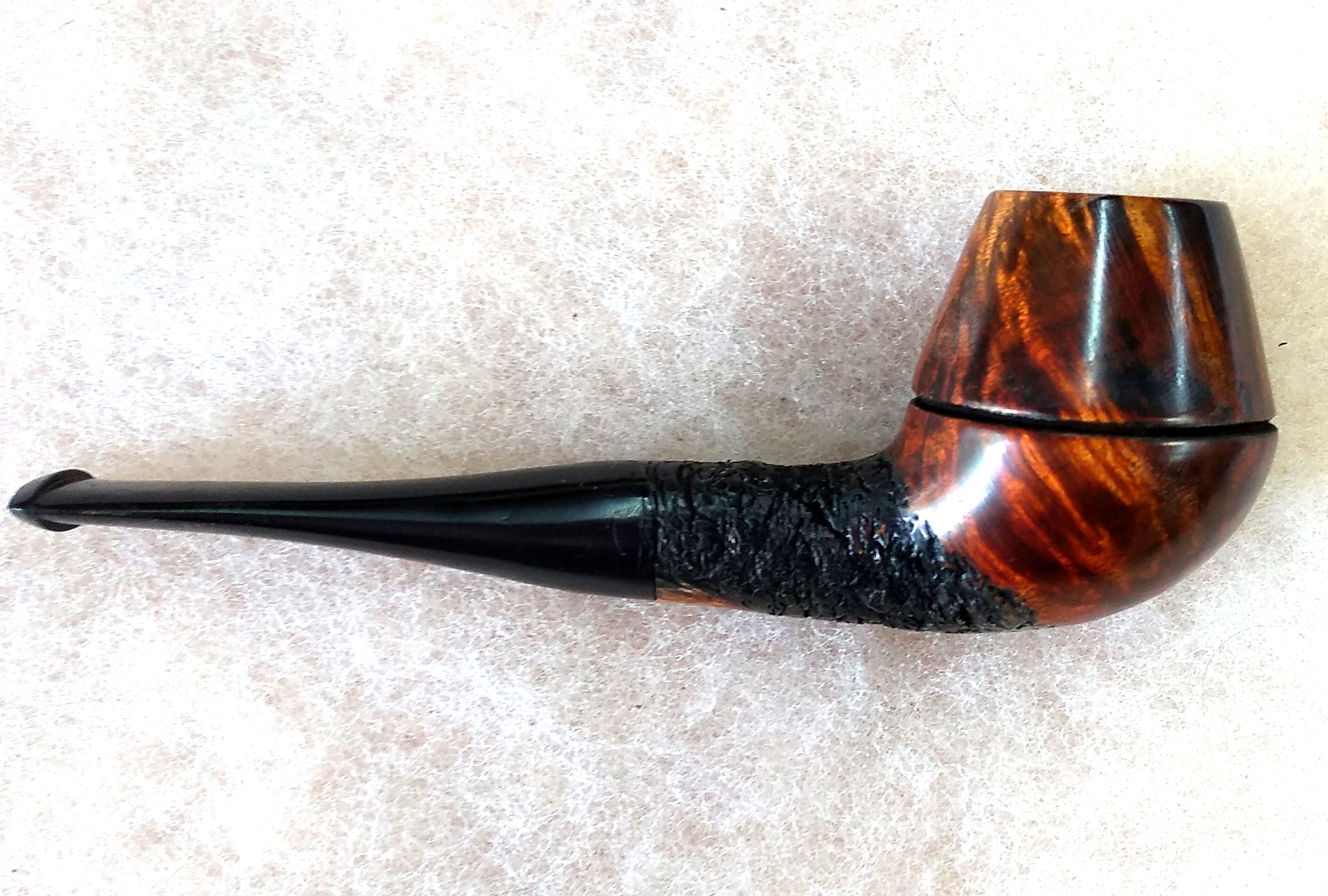

Here's my submission. My first ever Bulldog. The shank is a bit thick I think, but its a decent pipe that will be a good smoker.

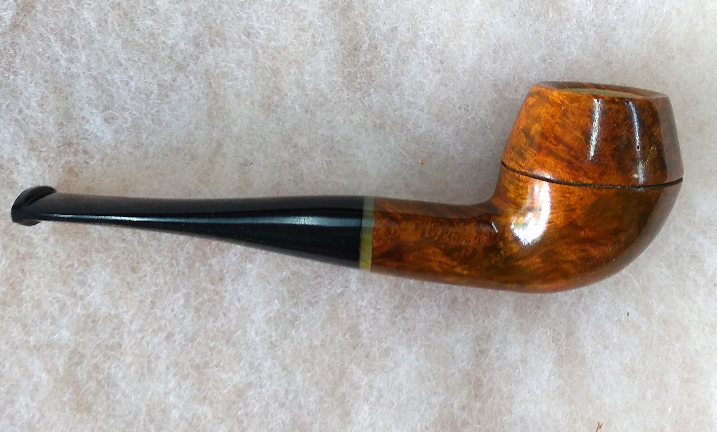

Post by Adui »
Second and last offering, whoever gets my name may choose.

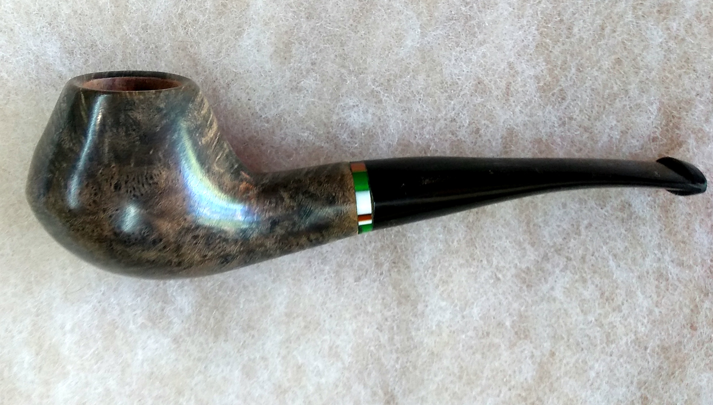

Post by n80 »
Here is my entry:
