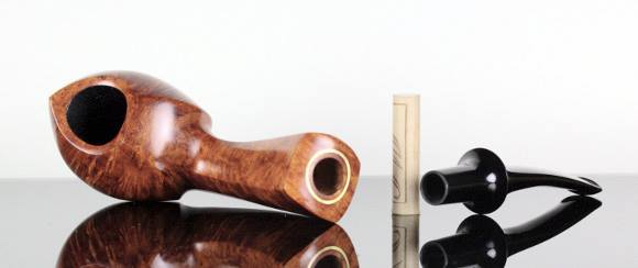

Re: PITH 2016!!!!!!
Post by calsbeek »
Its been several weeks since i posted this and so I thought I'd repost in the hope for clarity. cheers:
I'm beginning to think that I don't know what a military mount is.
does it have a tenon at all? Or is it just a tapered rod that fits into a shank that has metal reinforcement?
and if the latter, does it need the brass ring inside the shank as well as the cap outside? just one?
can someone clarify EXACTLY what we're making here?
and I'm super sorry for such a naive start to this PITH
Jthompson1995
Posts: 186
Joined: Sat Apr 13, 2013 6:32 am
Location: Parkville, MD
Re: PITH 2016!!!!!!
Post by Jthompson1995 »
calsbeek wrote:Its been several weeks since i posted this and so I thought I'd repost in the hope for clarity. cheers:
I'll try to explain my understanding, though I have yet to make a military mount pipe.
In essence, the defining characteristic of the military mount is the tapered "tenon" on the stem. I say "tenon" in quotes because the tenon is usually an extension of the stem instead of having a stepped shoulder that fits against the face of the shank. Ideally, this tenon is fit into a mortise with a matching taper so plenty of surface contact provides the needed friction to hold the pieces together. That being said, I just bought an estate kaywoodie that is basically a Peterson clone that the mortise has parallel walls and does not match the taper of the tenon. The fit is still secure but it is only touching at one point along the tenon, not the entire length.
As to the reinforcement, you are basically making a wedge with the tapered tenon that, if pushed hard into the mortise, will push outward on the walls of he mortise and could crack the shank. The metal ring around the mortise or the metal cap on the shank provide the support needed to stand up to this force. Only one or the other type of reinforcement should be needed, not both. I have seen pipes made with an acrylic shank cap and no metal reinforcement but would be hesitant to do so with my experiences with acrylics and the like.
Hope this helps clear things up a bit.
Anybody can become a woodworker, but only a Craftsmen can hide his mistakes!
-Walter Blodget
mightysmurf8201
Posts: 712
Joined: Sat Jan 07, 2012 12:44 pm
Location: Hudson, OH
Re: PITH 2016!!!!!!
Post by mightysmurf8201 »
I'm not good with words, so here's a good example in picture form of a military mount done with a brass ring. As you can see, a shank cap is not needed when done this way as the brass ring serves as the reinforcement so the shank doesn't split. The stem just gets lightly wedged into the mortise and the friction holds it in place. This is a James Gilliam piece. Hope you don't mind, James.

calsbeek
Posts: 203
Joined: Mon May 11, 2015 12:11 pm
Re: PITH 2016!!!!!!
Post by calsbeek »
awesome. This helps mucho.
cheers!
