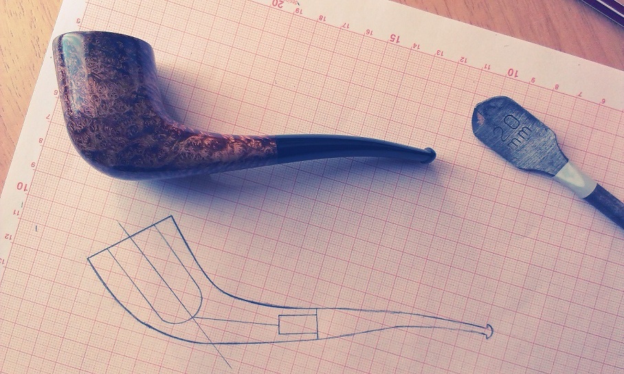

I'm preparing to a second attempt with Zulu. I gathered all the informations from you guys and sketched another one with a bowl leaned forward (compared to previous one).
Does it still qualify as Zulu?

Re: #3 Zulu
That design comes closer to a horn. Try something in between, less cant than the drawing but still less heel than the one you made. If you like the shape just make as many as you can and try different variations, that way you can really learn which lines work and which ones don't.
Re: #3 Zulu
That would definitely look better, but I'd grind some material off that spoon bit first. Make it closer to a parabola. Using it as-is would result in quite a thin spot there.W.Pastuch wrote:...but still less heel than the one you made.
Re: #3 Zulu
that's a spade bit, not a spoon bit
Nitpicky of me, but a HUGE difference!

Re: #3 Zulu
Thanks for the catch. My brain's image<-->name retriever is OK---I do know the difference---but the signals get scrambled on the way to the keyboard occasionally.Massis wrote:that's a spade bit, not a spoon bit
Been breathing too much ebonite dust lately, maybe.

Re: #3 Zulu
As long as it's not the stinky stuffLatakiaLover wrote: Been breathing too much ebonite dust lately, maybe.
Re: #3 Zulu
I completely missed the fact that you posted this, and not Jakup, so I was fully under the impression I was correcting a novice, not some old timer who should know betterLatakiaLover wrote:Thanks for the catch. My brain's image<-->name retriever is OK---I do know the difference---but the signals get scrambled on the way to the keyboard occasionally.Massis wrote:that's a spade bit, not a spoon bit
