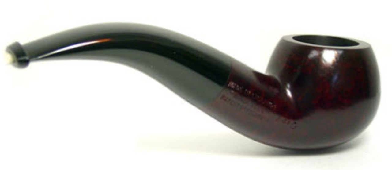

The gold standard for graceful execution:

LatakiaLover wrote:The gold standard for graceful execution:
George, what's the make on that one?
Sent from my bloopty-bloop using hooty-hoo.
Re: Author
Posted: Tue Aug 17, 2021 11:03 pm
by LatakiaLover
It's a Dunhill from 1927 or '28.
Someone was there at that time who understood "swan neck swoopy & graceful" better than anyone else in the history of pipemaking.

I found a similar pipe:
https://www.smokingpipes.com/pipes/new/ ... _id=156146
it isn't quite as "swoopy" as the example from the 20's, but it's close enough that it can give a good perspective.
Re: Author
Posted: Wed Aug 18, 2021 12:40 am
by Sickle
I've never noticed how big Dunhill's buttons are
