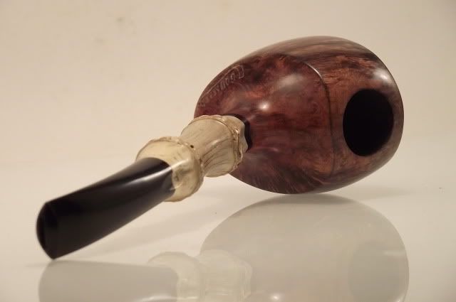

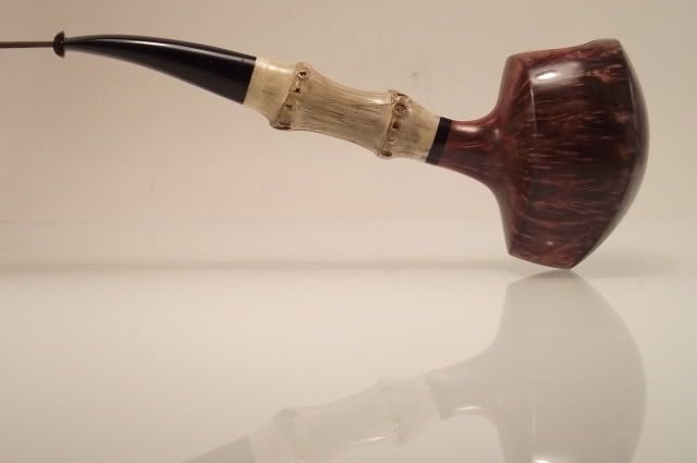

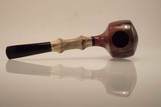

Please be so kind as to let me know what you think.
Re: #1104
Flamed and "Bird's Eye" correctly for the type of pipe, and good execution.
Regards.
Felix
Flameado y "ojo de perdiz" bien adaptados al tipo de pipa, y buena ejecución.
Abi Natur

Re: #1104
Post by Abi Natur »
Hi Charl,
It is a beautiful grain that you placed very precisely into this freehand shape,but to my personal point of view the cheeks seem combined with the bamboo shank kind of heavy.
" Keep it simple until it gets complicated "
http://www.canaanpipes.com/
Re: #1104
Beautiful pipe, but I'd have to agree with Abi. I think it would go a long way to balance the pipe if the cheeks were concave rather than convex. Also, I think the stem might look a little better if it were narrowed out a bit at the apex (not quite so abrupt towards the bit.) With all that said, however, this is still a very nice looking pipe and one I would be very happy with if I had made it. Nice job.
Re: #1104
BTW...is that a bamboo extension? I'm guessing so, but it almost looks as if it is some sort of bone imprinted to look like bamboo. Either way, I like it a lot.

Re: #1104
Thanks for the replies, appreciate it.
Looking at the photos again (I always seem to find even more faults), the top of the stem could have a bit more taken off. And I agree, the bowl does look a bit "heavy" for the bamboo. Should maybe have been a bit more "delicate" (for want of a better word!) to compliment the bamboo more.
