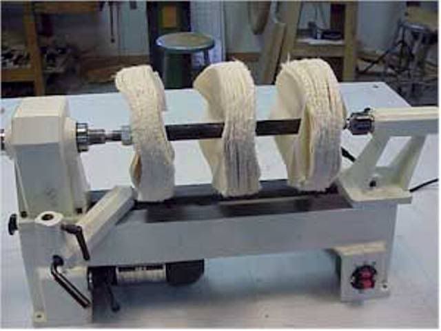

I just purchased this buffing mandrel kit today for my lathe.
