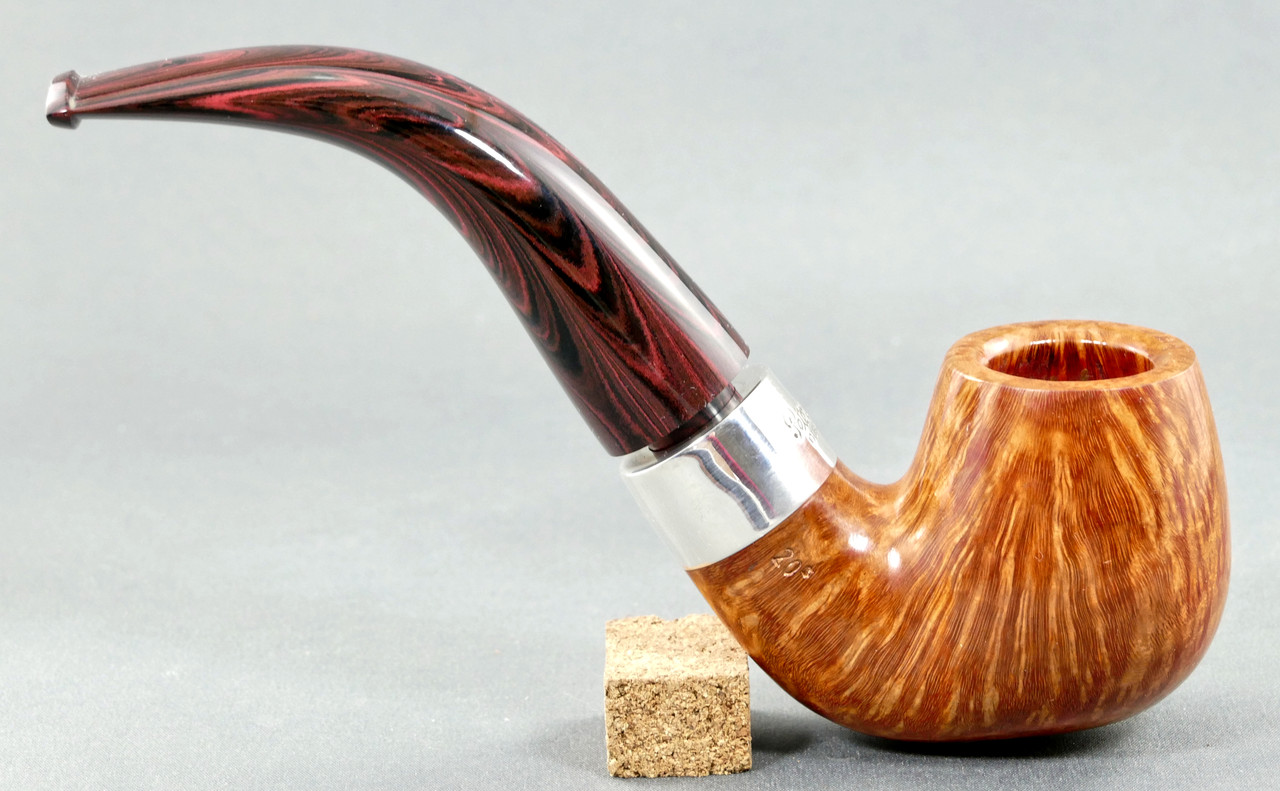

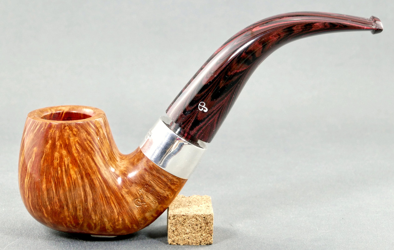

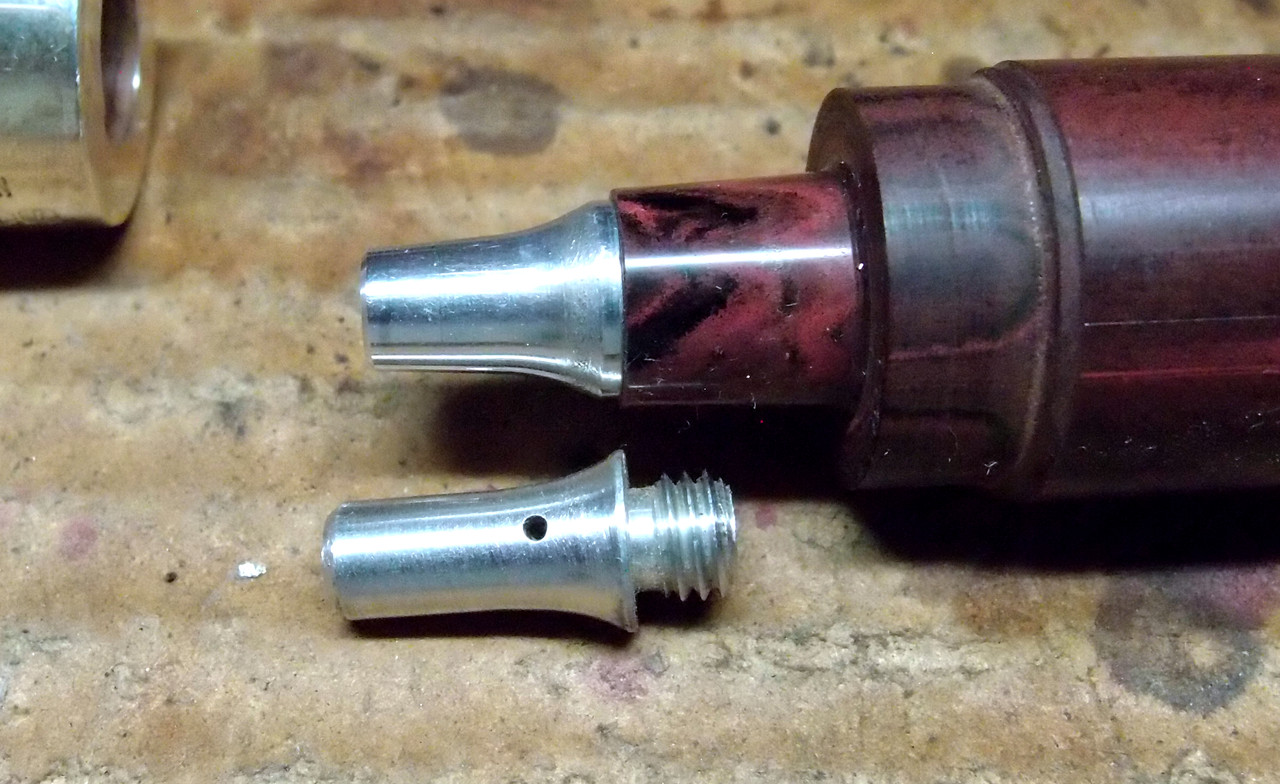

Yes, the pic with the original stem is fully inserted. :shock:
Why was it done that way? To fit everything into the available space. More about that in a sec.

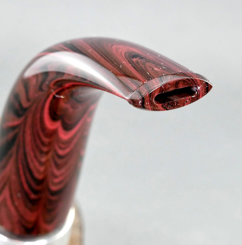

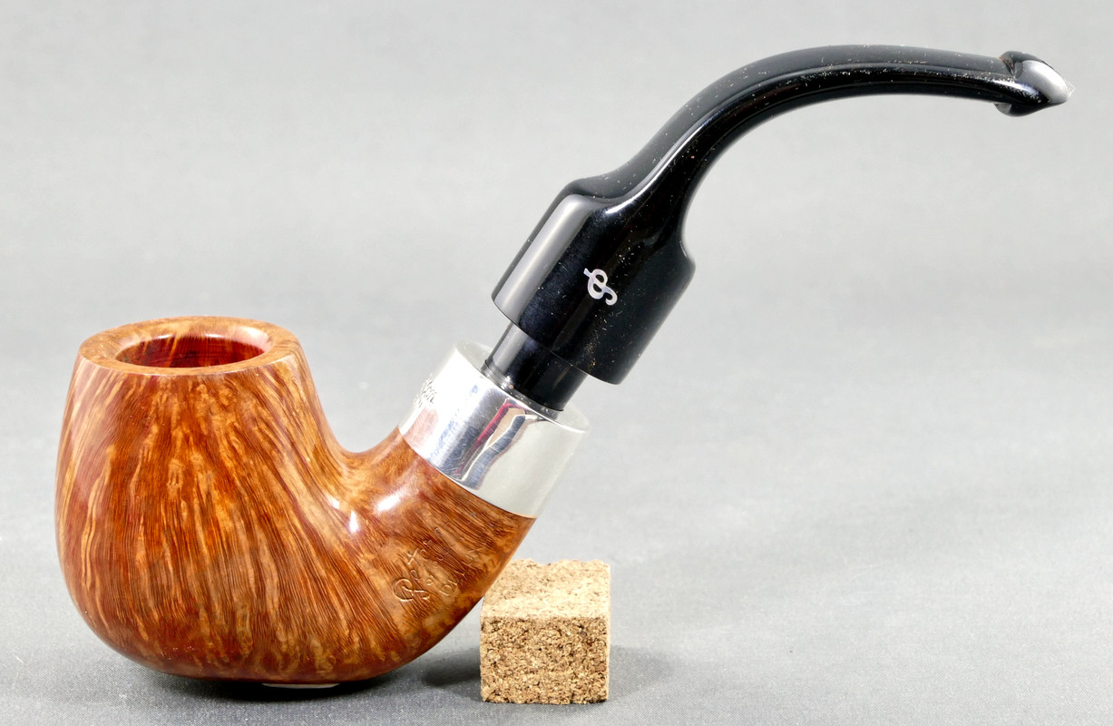

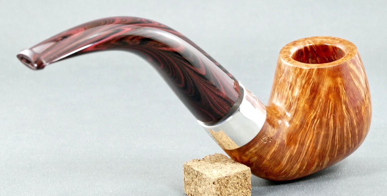

Besides sporting "shine blasted" execution (no crisp lines), the stem was a square-sided block over .2" thick (seriously?) and made of acrylic (which the owner hated as a categorical thing).

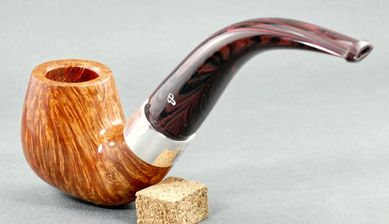

"If possible, make it look like one of those elegant pipes in Pete's century-old catalogs that has a tapered stem. And use rubber. And make it brindle... because I effin' like brindle," said the owner.
It was possible. :D

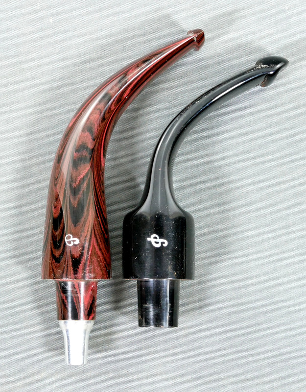

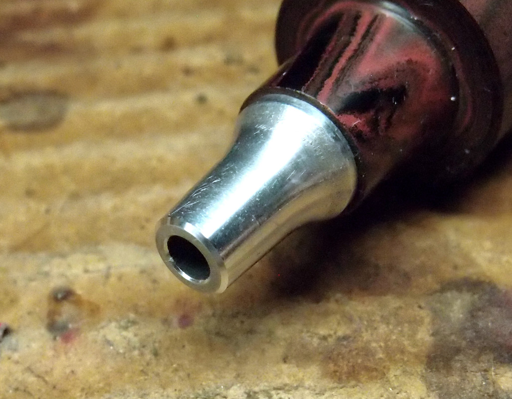

To fit all the pieces-parts and keep the shank/stem gap looking authentic when assembled, the tenon and the condenser widget had to be shortened by about a millimeter each. Kinda cheatin' but kind of fun to get away with, too. :mrgreen:

If you did nothing else than get rid of the p-lip it would have been a complete success.
Did you make the metal insert?
Posts: 3120
Re: Peterson System stem replacement
No, just cut down the original.
10-4 on the new generation of P-lips being simply bad. :(

I've made a few p-lips proper, with the little bend in the airway at the end so it's coming "up" rather than "back". They're a real pain in the ass.
Great stem George, gives that pipe a real 1920s vibe.
