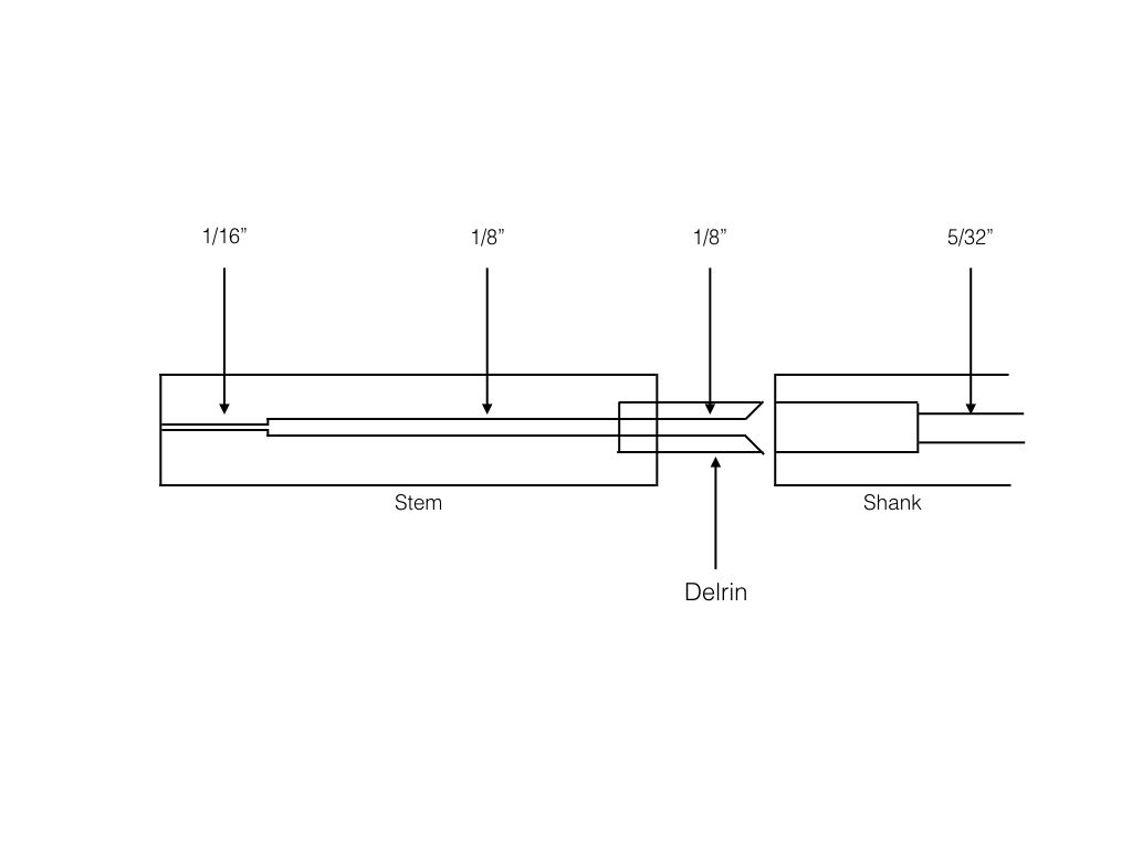

This may be a dumb question but here we go... After reading up on hand cutting stems the consensus seems that a 1/16' slot is drilled at the button, then a 1/8" airway is drilled for the remainder of the stem. Before you epoxy in a delrin tenon it is to be drilled out to 5/32". This leaves 2 shoulders, one at each junction which is removed with tapered bits. Here is my question, why can't the tenon be drilled to 1/8" along with the stem? Since the head of the tenon will be countersunk anyways, it would place the 1/8" to 5/32" junction at the tenon/mortise face. Is the 1/32" drop in this transition to blunt and not allow for a evenly tapered air hole? I attached a sketch of what I am trying to say.
(47.03 KiB) Downloaded 30 times

Who said to drill the stem airway to 1/8"? That seems weird to me. I drill with a 5/32" tapered bit to within 1/4" of the other end, then 1/16" from the other end of the rod. I don't have any shoulders in my airway. It's 5/32" from the slot to the chamber.

I'm not sure why you'd want a 1/8" bit at that point. I guess it doesn't matter because you're still finishing the airway with a 5/32" bit. The reason for drilling delrin separately is that it tends to flex the further it is from the clamping area. Having a hole started helps it stay centered, I think. Todd's method seems overly complicated to me, but I guess it would do the job.
Re: Stem air hole size
Quite a few of the cherished old English have 1/8 airways. And many highly regarded danish makers too. For airflow, if the slot is opened properly to the airway, 1/8 is plenty for good airflow. 5/32 is almost overkill when the slot is opened all the way to the airway properly, but most are not so there is a pinching effect.

So you could use a 1/8" bit for the entire draught hole, even in the shank? Then just make sure the slot is opened up as wide as possible?
pmbattles wrote:Premal,
You could and the pipe would smoke fine for most people. In my opinion it's good to have a larger hole in the briar to account for swelling and residue buildup. Where the slot meets the airway is where it is important to be opened up wide enough. The width of the slot at the opening does not matter except that it is stronger the more narrow it is and only has to accommodate the volume of the airway. I've found. Experiment with different sizes and smoke them to see the differences.
A properly opened 9/64 airway in the stem will have better airflow than an improperly opened 5/32 airway in the stem. I have seen this in more than half of the 5/32 airway pipes that have gone through my hands over the years.
This my thinking too. I use 4mm in the shank and 3mm in the stem.

I use 5/32 in the airway all the way through and like how the pipes smoke for me. I've gotten good feedback from my customers on my pipes and their open draw. Not saying it's wrong to do it different, probably just a preference thing. My advise is to test it first for yourself and whatever you decide on, stick with it so your customers get the same smoking experience no matter which pipe they buy from you.
As Premal said, the slot being properly opened probably makes the biggest difference. You don't want the air to pinch at the end of the airway. That tends to cause condensation to accumulate and restrict the draw.

Grind a used up airway drill flat so it will fit freely in the slot and test your opening.
