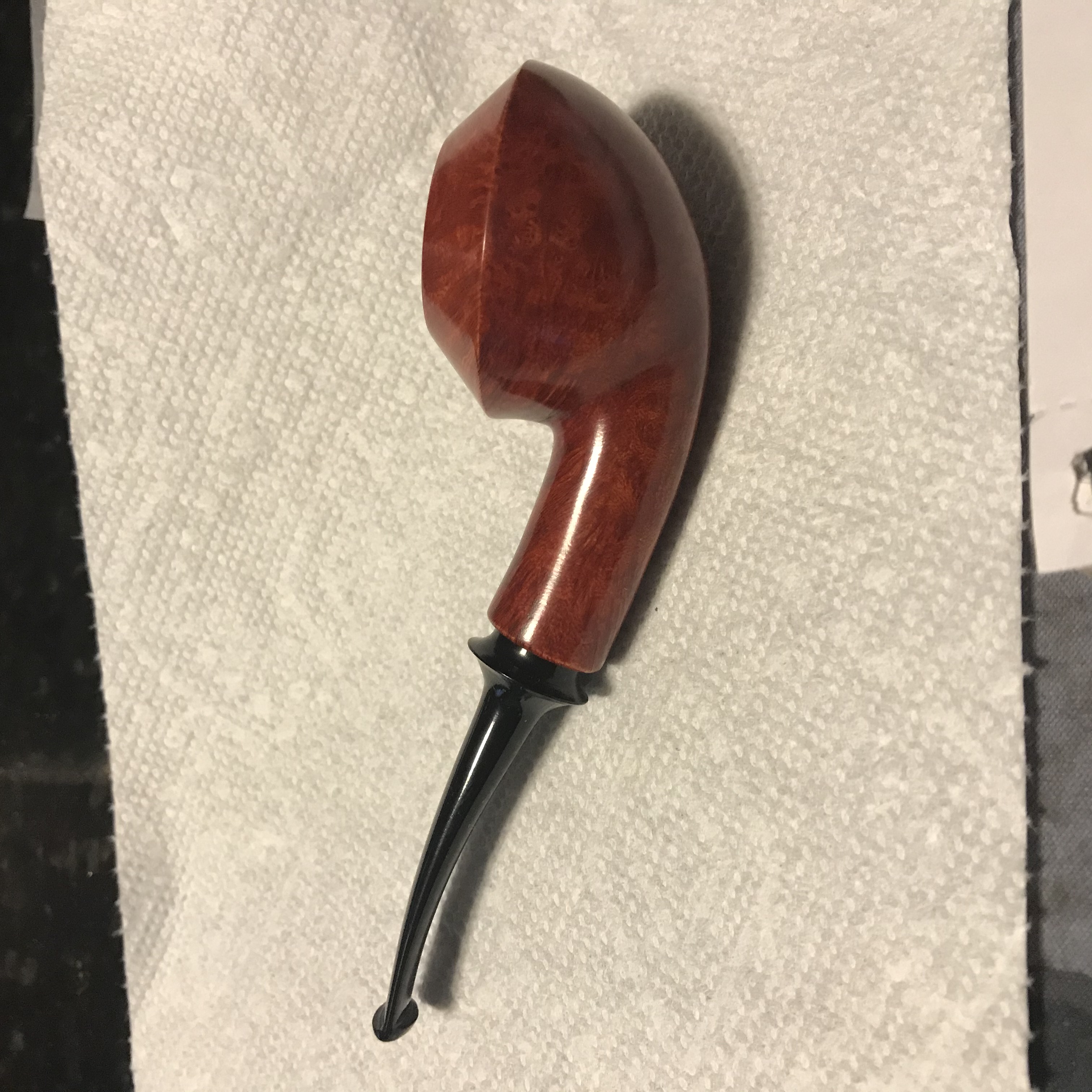

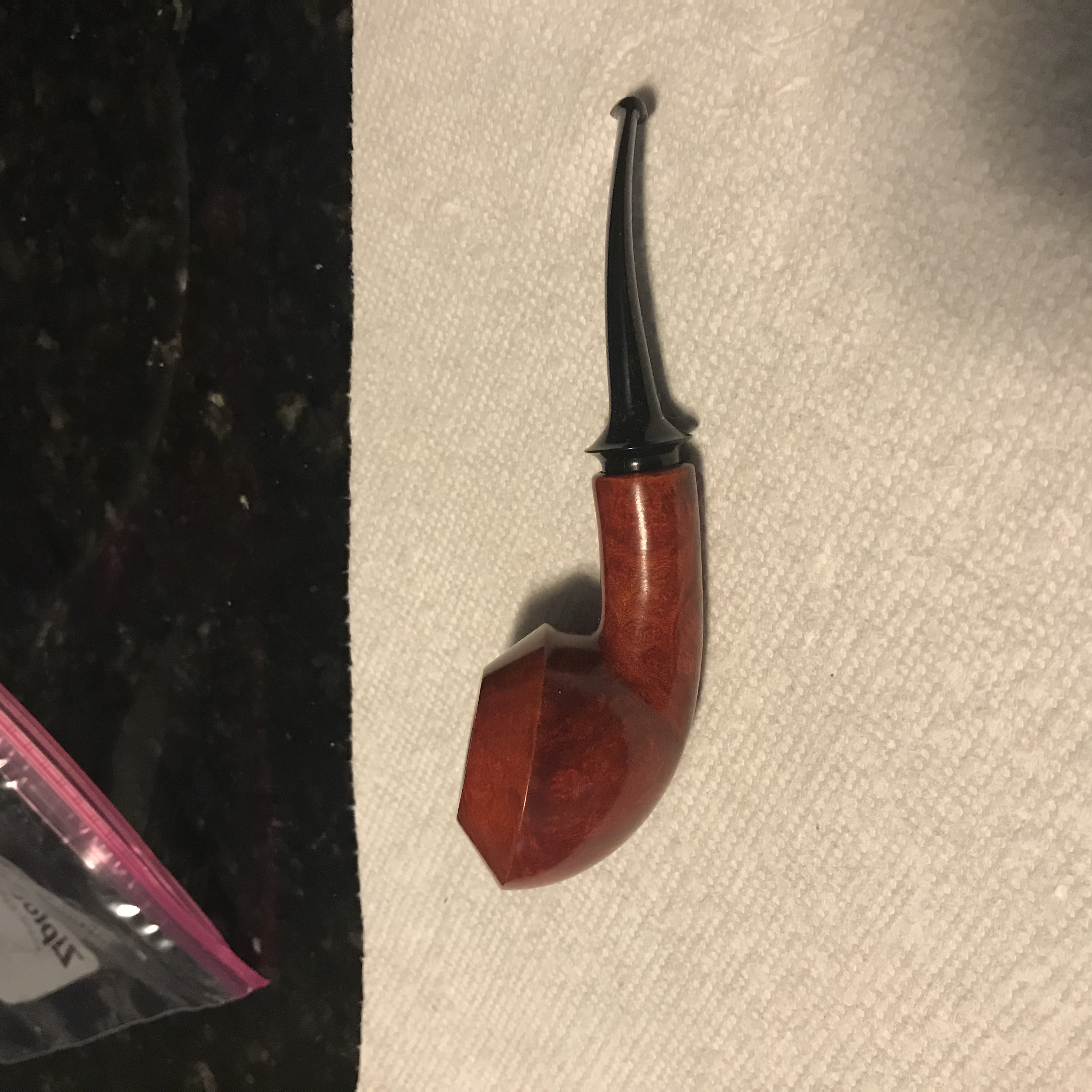

A couple of firsts in this one for me, first Bulldog and first diamond taper stem, it's also a military mount (not my first time).

The only arguable error is the floor of the bowl probably being too thin. .25" is the minimum regardless of pipe size (it's a briar thing).
Also, with this sort of design, tilting the chamber radically to avoid the problem only trades it for a different one: Charring of the chamber wall on the shank side above the drafthole.
In short, if you make another of these try adding a little beef through the heel.
Before anyone gets riled up: I know Bo Nordh invented the shape and etc. I also know what comes across my bench.
PS --- If you've measured and it's .25"+, and the chamber isn't whacky angled, then never mind. The pipe will only give a short smoke, but that's OK. Form must follow function, not the other way around.

Agree with George. That is a tough pipe to make with adequate floor thickness. Have tried and failed several times. Seems like the Giegers have some sort of trick with their Bodog pipes, named after Nordh of course. Can’t remember what they do but I think it has to do with a cone shaped chamber and possibly an angle to the chamber as well.
