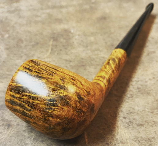

Hey, all. I wanted to share with you a very very think shanked billiard that I have made.
To tell the truth; after drilling and rough shaping stem on my lathe, I made the mistake of unchucking it, and then chucking it back off. I lost my concentricity and it deviated from the normal axis of the shank. So, when I twist it around in the mortise, it doesn't stay aligned properly.
It was very demotivating, but I definitely won't make the mistake again! :lol:
I do like how this pipe came out, but there is something funny about the stummel that I cant put my finger on. I do know the transition from shank to tobacco chamber looks a bit off, I think I should've taken off more material on the bowl, at that junction.
I do have a billiard that I'm almost finished with that I will be posting tomorrow.
Any feedback is very appreciated! :thumbsup:

I am certainly no expert but a rule of thumb I try to go by that Doc told me is that the front of the stummel should essentially match the back. In the case of your pipe I would have removed material from the shank stummel junction to match the curve on the back. Something that has stuck with me is he said to view a billiard as two separate pieces joining together. It really helps visualize how the shape should be. He has a diagram of the example floating around here somewhere that is great. Hopefully that makes sense.

luttrell31 wrote:I am certainly no expert but a rule of thumb I try to go by that Doc told me is that the front of the stummel should essentially match the back. In the case of your pipe I would have removed material from the shank stummel junction to match the curve on the back. Something that has stuck with me is he said to view a billiard as two separate pieces joining together. It really helps visualize how the shape should be. He has a diagram of the example floating around here somewhere that is great. Hopefully that makes sense.
Other than that great looking pipe.
Thank you, Luttrell. I appreciate your input. I will try to keep those two looking the same, it’s something I have struggled with! And I’ll look for that post, thanks!
Re: Pipe #15. Pencil Shank Billiard.
One thing that I've found that helps is to use a 3 or 4mm round file to cut that transition in, right where you want it. Then shape the bowl down to the transition, and the shank in.

seamonster wrote:One thing that I've found that helps is to use a 3 or 4mm round file to cut that transition in, right where you want it. Then shape the bowl down to the transition, and the shank in.

This the diagram to which Steve refers.
Basically, the billiard shape can be broken down into 3 geometrical components- 2 truncated cones and part of a sphere.
Once you understand that, you can see what you have to do to achieve the shape.
For what it's worth, I don't think this is a "thin" shank. It looks aesthetically accurate for the pipe. If the shank were longer, then I think you might should have gone a bit thicker with a greater taper, but given the shorter length of the shank, I think it looks well balanced.
