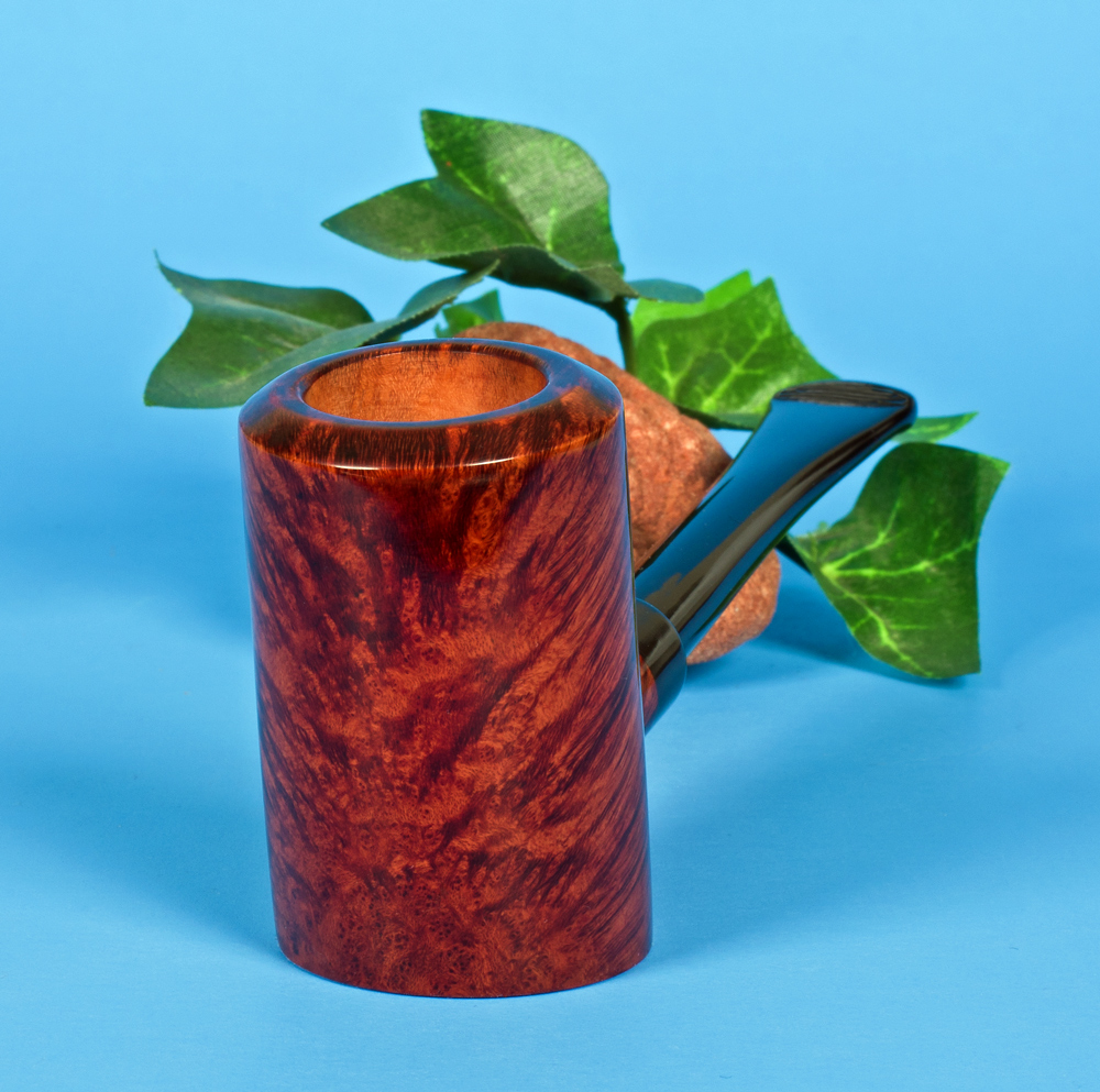

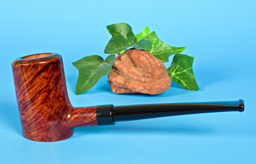

That's not true in my opinion. Hardness is just hardness, the shape of the bite zone is a separate topic.LatakiaLover wrote:the "tooth hardness" thing---is much more a matter of shape than material, I think. The early acrylic pipes were price-point-sensitive ones instead of high grades, and were given thick, chunky, blocky stems to save labor costs
I have an industrial pipe with a very nicely shaped acrylic mouthpiece that has a thickness of 3,8mm at the bite- perfectly acceptable even in high grade pipes (the button isn't too tall, the shape isn't clunky, just a very well made mouthpiece. The draw sucks, but that's unrelated). Still this pipe feels uncomfortable to me. It makes a "click" sound against the teeth and it feels hard, despite the fact that it's shaped correctly.
