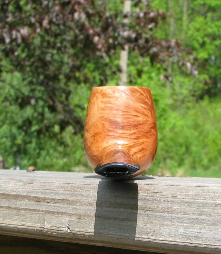

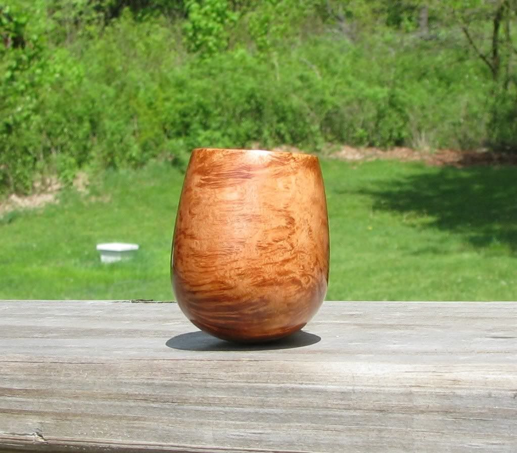

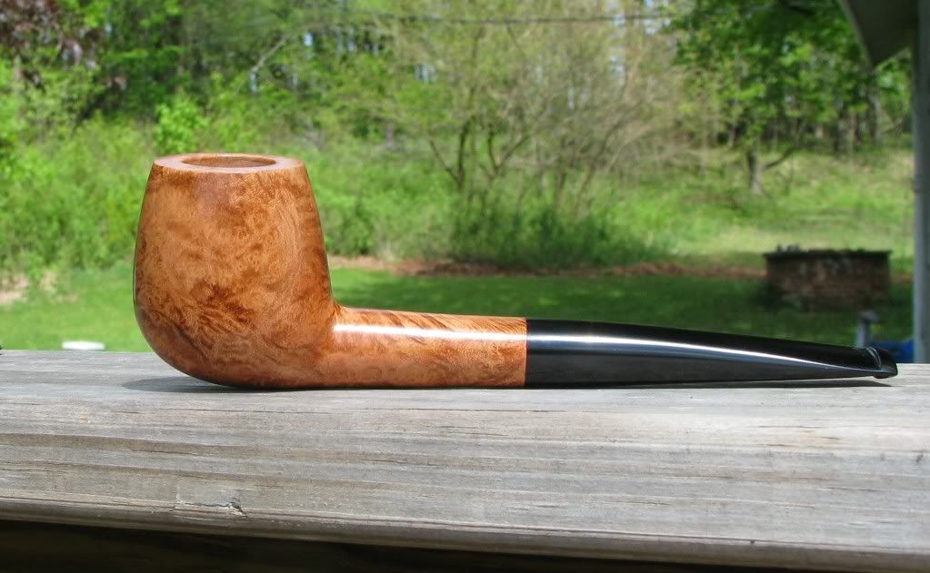

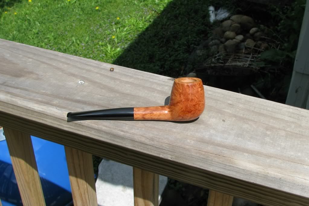

Another stab at a billiard. Comments, critique, pointers; all are welcome. Thanks gents!

Shaping looks pretty good overall, but I'd say it's still a little chubby, more of a brandy than a billiard proper - there's still a billiard in there, and a little stock removal would find it.

Too fat on the back still? I was trying to make it match the profile of the front curve.....so I'm guessing that's too fat as well. I hate to be the beggar, but a Sasquatch 'Paint'-job with the lines would deeply honor me! :D

I'd say take it in a direction like this -
I have canted the top just a hair more forward, and "squared up" the bowl and thinned the shank a touch.
Whether you thin the shank a bit depends totally on the final bowl dimension - if you have a 3/16" thick bowl around a 3/4" chamber, a thick shank is gonna be disproportionate.

And don't feel alone in this battle. I did probably 10 "Oh yeah this will be a billiard" pipes before I finally did one I was happy with (and I don't consider at all that I've mastered it - shit, I sometimes get a billiard when I'm trying for a bulldog). The key is taking off enough material. It's easier to make big fat Italian pipes than little thin English ones.

I have no problem with the 'fatness'. Sure you could cut it down a bit but still, I have seen many 'so called' billiards which were just as fat. If you do cut it down try to keep the same curve or slightly less from top of bowl to bottom. I would, however, start the stem taper closer to the junction to make it somewhat skinner and spend some more time cleaning up the button, it's still a little shabby, lots of tool marks, rather amateurish in overall appearance. bob gilbert

Thanks for the input Bob. Are you talking about the slot? That's an area I have trouble with that I'm trying to improve with each pipe. Even my smallest tools have a hard time getting in there. In the photo the outside of the button looks dull and marked-up, but it's just shoddy focus and surface debris....

I like the wine glass shape variation you came up with. While it does look like the back is a bit off from the front, there is also an optical illusion generated by the shank. Other than what may be an illusion, the rest looks very symmetrical. I also looks like you have some decent brier to play with. Pick and choose from the criticisms based on what the pipe smokers around you like when you show off your creations. Best wishes :D

I dig the chubby look. I agree that the stem taper should begin at the stem-shank juction and the button should be thinner. Nice pipe.

for me, making a billiard with the largest circumference at the mid point up the bowl is the most difficult. Keeping the bulge from drifting up or down, and if it does drift making sure it drifts equally all the way around, is the key to learning to craft all the possible variations on the basic shape. So for learning, I would say that is the way to go.
This pipe looks nice. proportions of all the parts look to fit well together.
the follow observation may be optical illusion--on the front shot, the left side near the bottom looks a bit fatter. it looks like the shank meets the stummel just a bit off center, causing the apex of the arch along the bottom to be a bit to the right

My opinion (such as it is) is that a billiard should not have the widest point at the middle of the height of the bowl, but further down - closer to the top of the shank. A billiard that has the widest point at the middle of the height should be called a "barrel". :D
