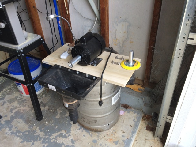

As a beginner with very similar goals I went with a 1/2hp Enclosed Grizzly motor, the Beall setup, and an arbor from Kurt that I can use to mount normal sanding disks (the Beall won't do that). It's working fantastic in my limited experience. I have a duct in the front I can attach to my Shop-vac, and I just spin it around a bit when I buff to get a comfortable angle.
- IMG_1903.jpeg (101.55 KiB) Viewed 4040 times
Mike
